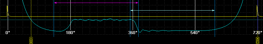

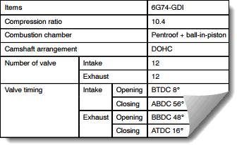

Mitsubishi Pajero 6G74 (GDI, DOHC) Valve Timing:
