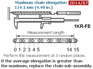

Inspection_chain_1KR-FE_a'14

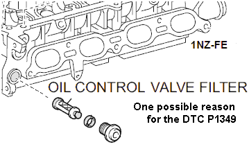

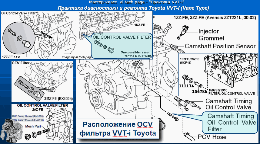

OCV_filter 1NZ-FE
OCV_filter 1NZ-FE

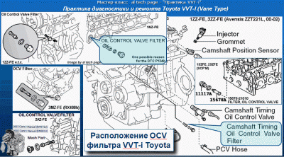

VVT-i OCV Filter Location 1

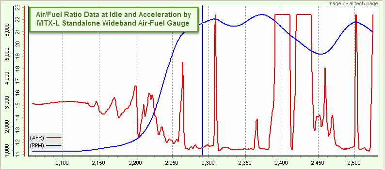

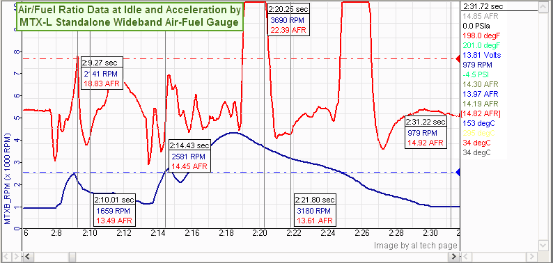

Air/Fuel Ratio Data from Innovate MTX-L Standalone Wideband Air-Fuel Gauge

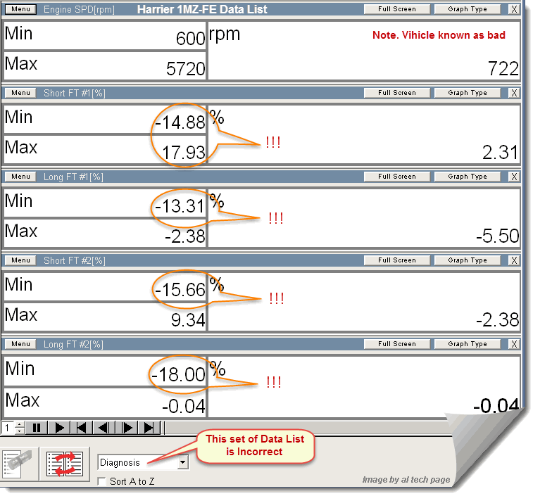

Harrier Data List
Harrier Data List
Harrier Data List
