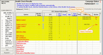

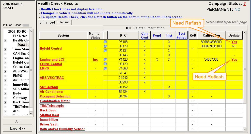

1/2 Off. Часть данных о состоянии другого старенького RX40h:
Health Check Results of RX400h a '06

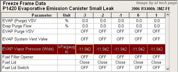

Freeze Frame Data of RX400h a '06

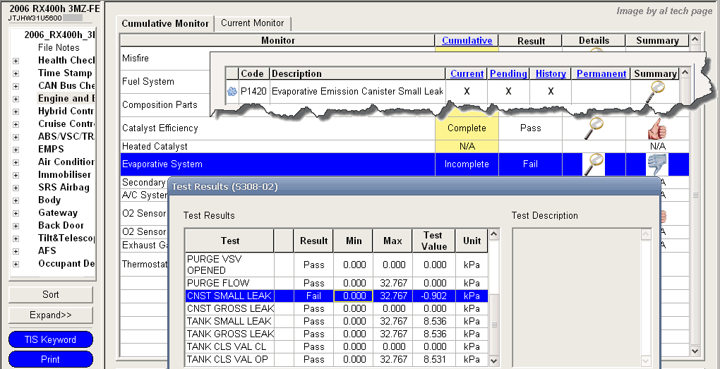

EVAP System Monitor Test Results of RX400h a '06
